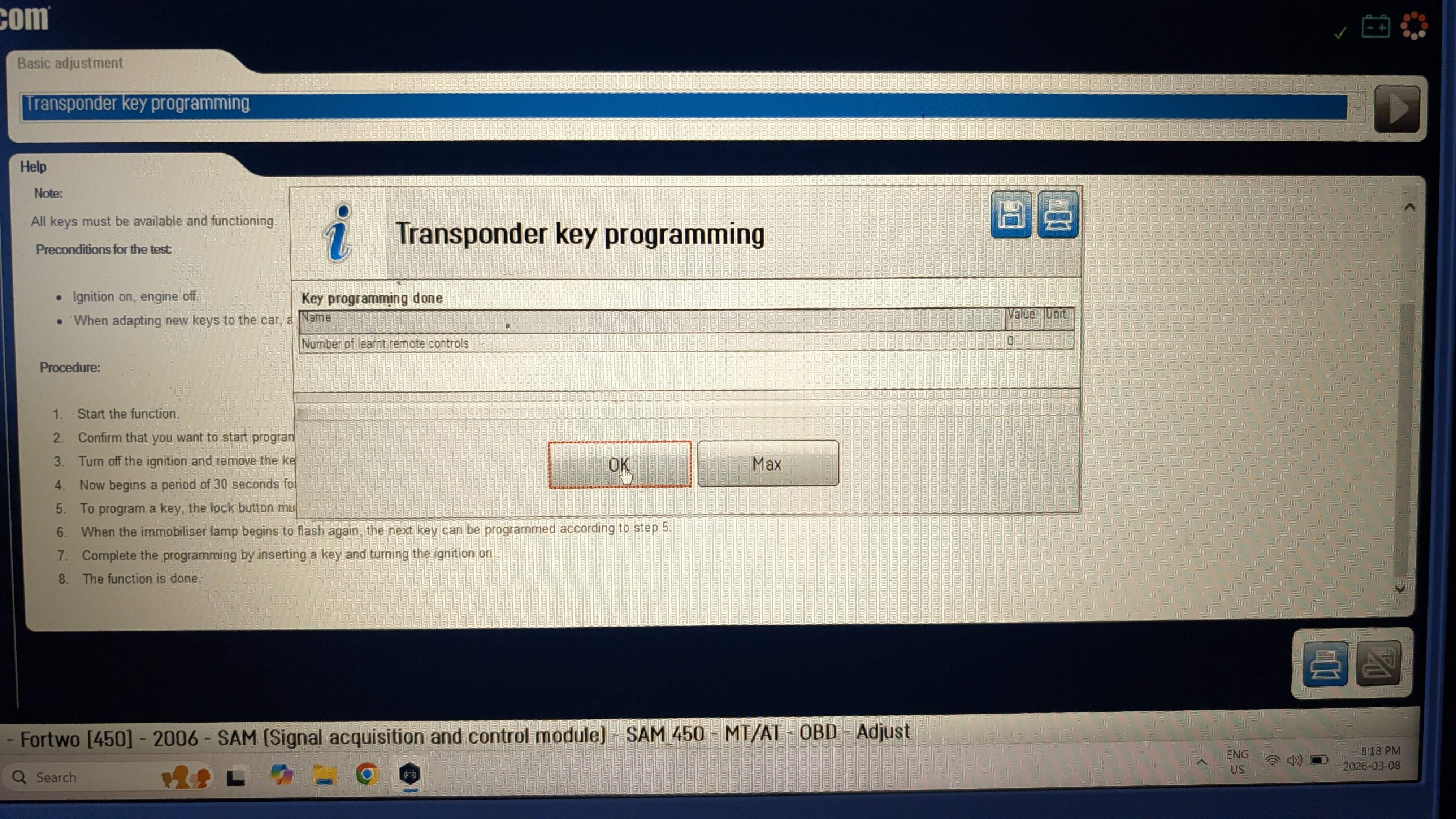

none... i have no idea why it would do that but maybe swapping out the ignition antenna reading loop with a used one if you can find one (im guessing theres one near the ignition like my volvo has) or keep tinkering with erase and teach functions and hope it works one time or maybe try adding extra keys -

So I bought one of the Delphi 150 from AliExpress thanks to the tip from LooseLugNuts. Good news is I can connect software run through the key programming and get by the immobilizer and the car starts! Bad news is it says key learned 0. So everytime I'd want to start the car I need to run the fob learn again. I'm assuming my key antenna is bad and that's why I never actually learn the fob to the sam/ecu. Anyone else have any ideas? -
