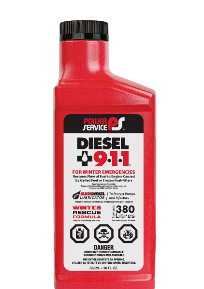

stick a heater under the back....or a magnetic block heater on the oil pan for a few hours to give it a better chance diesel 911 would be good to add if you suspect gelled up fuel -
you have 3 old ones in your engine that you should (very carefully) replace with 3 new ones; ) and its a good idea to ream out the glow plug bores while youre in there...i remember welding a long bolt to a drill bit to get that job done...i dont remember what sized bit i used but i do remember coating it in grease first to minimize the amoiunt of carbon that inevitably falls into the combustion chamber
