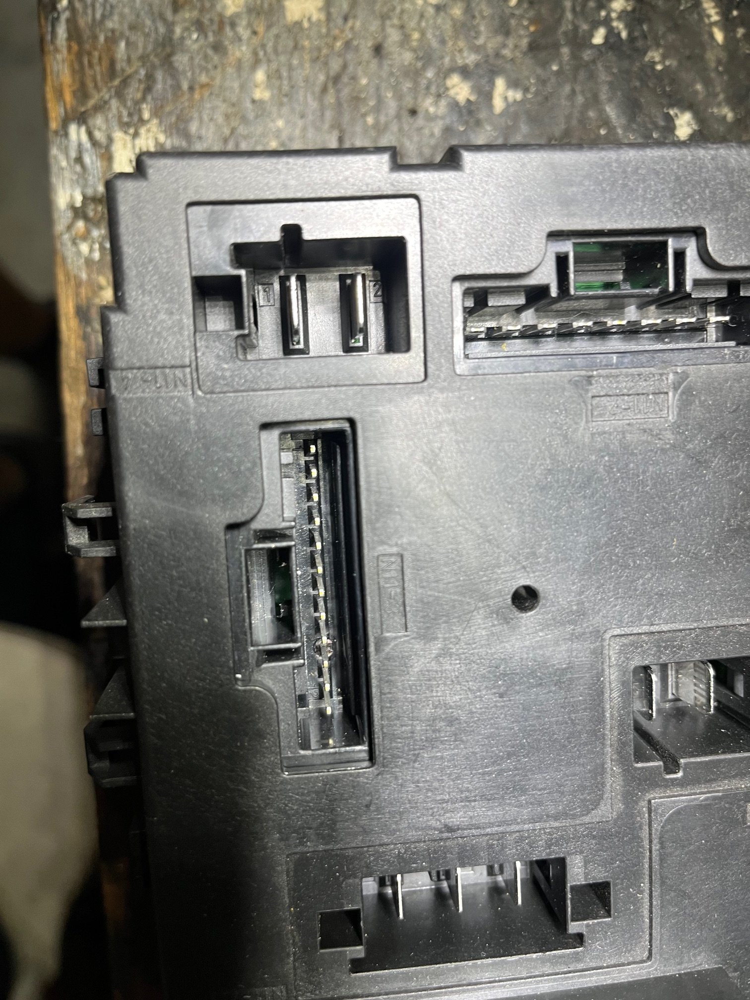

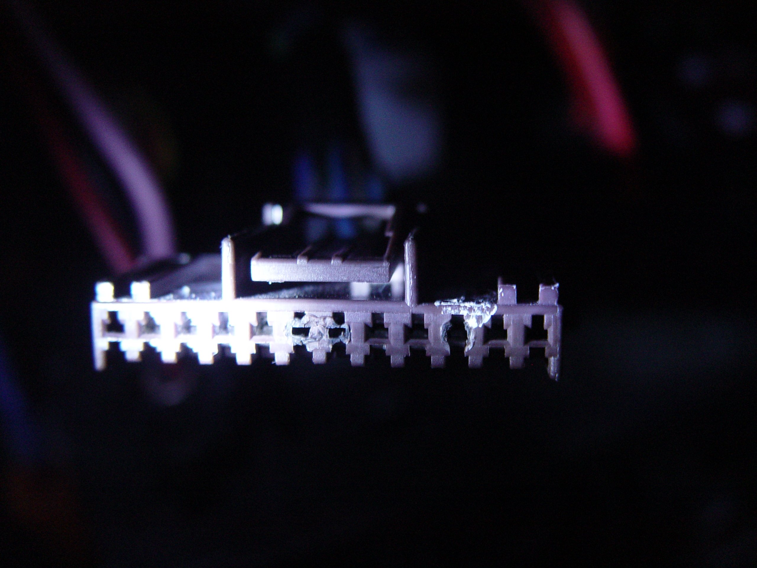

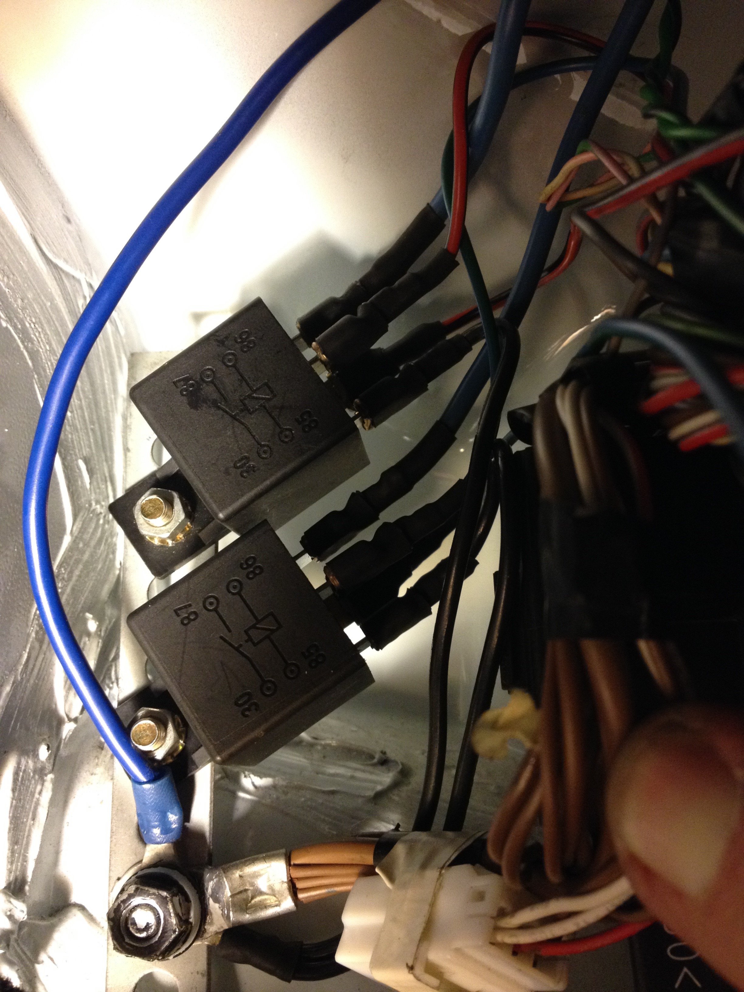

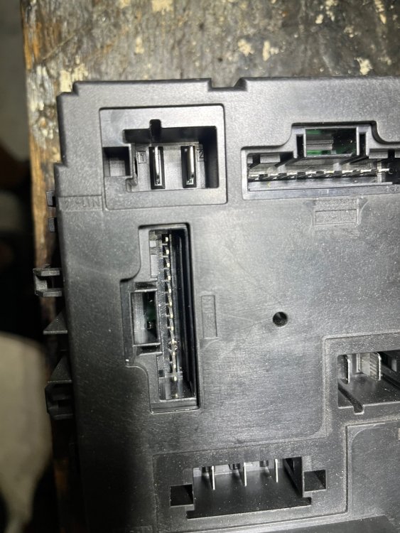

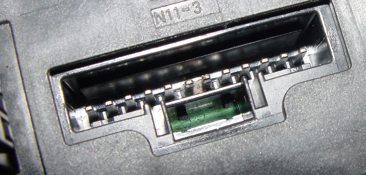

SAM N-11-3 connector, probably heat damaged. Needs external relay for the electric fuel lift pump (and low beams on the same plug).

Fuel lift pump = the in-tank pump that supplies fuel to the high pressure pump driven by the camshaft. The N11-3 plug has its feed running through it and any heat damage on that pin (or the low beam pins) means you need to install external relays in those circuits before the circuit goes completely dead. The two melted ones in the centre are the low beams and the one third from the right is the fuel lift pump. I replaced this connector. This is the SAM that was changed and I have in reserve now, with a melted fuel lift pump pin on the N11-3 connector. This is the second SAM, where the two low beam circuit pins show heat damage. This one was recoverable and a new brown plug took care of the problem, combined with the mounting of external relays for the low beam circuits in order to take the amperage out of the SAM. -
