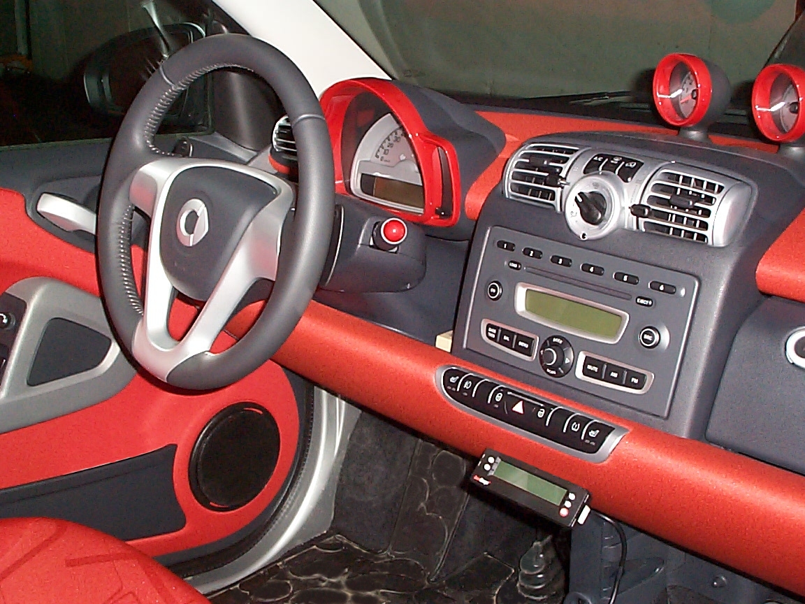

Tom P. Posted February 19, 2008 Author Posted February 19, 2008 I finally installed the ScanGauge II in my 451. I decided to go with a central mounting location for ease of visibility. The 12V outlet is still accessible even though the pic does not attest to that. I used the velcro supplied with the ScanGauge and it is secure (time will tell).It sure is nice to see actual KPH (that agrees with my GPS) along with the coolant temp and gas mileage. I added an XGauge to monitor DTE (Distance To Empty). I also like the TRIP computer for max. speed, rpm, temp etc.I matched the back-light colour to the 451's amber dash lights by using Red 2, Green 1, Blue 0 (if I remember correctly). Quote
