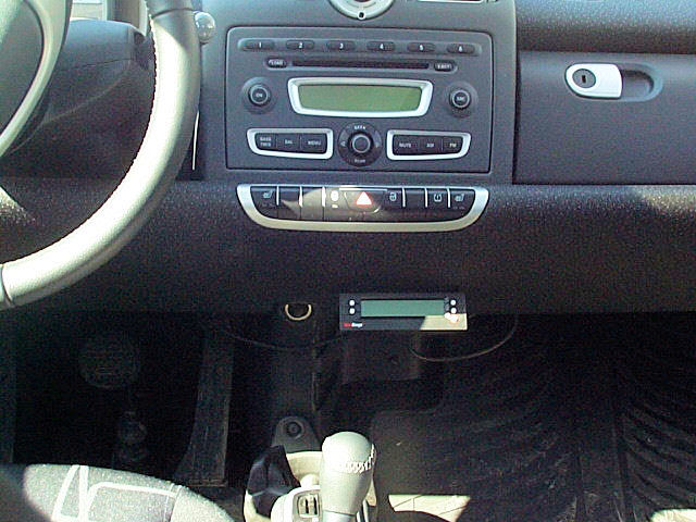

crankin Posted February 20, 2008 Posted February 20, 2008 I like the location you chose but I have busy legs and probably be knocking it off at every light. Quote
Tom P. Posted February 20, 2008 Author Posted February 20, 2008 I like the location you chose but I have busy legs and probably be knocking it off at every light.The pic is a bit deceiving. It is no where near my legs or knees... no chance of knocking it off. I am 6 ft. tall. Quote

Tom P. Posted March 15, 2008 Author Posted March 15, 2008 (edited) Well, my mounting location mid-dash below the button-row on the fabric (shown above in previous post) did not hold up and kept falling off. The velcro does not stick well to the fabric. So, I have moved the ScanGauge to the top of the cubby on the left side of the steering wheel as others have done. Velcro'd to the top edge of cubby where there is plastic to stick to. There is an opening in the back of the cubby at the top-right corner so no drilling required. Just put a fish wire through it and it will come out beside the fuse block under the dash, then tape the end of the ScanGauge cable to it and pull 'er back up and through. I put a blocker (alligator clip and tape) just where the cable comes through the opening in the back of the cubby so it can't slip back down if I disconnect the cable from the ScanGauge. The ScanGuage is quite visible in this location, through the spokes of the steering wheel, and looks quite good. Still lots of room in the cubby with easy access below the ScanGauge - it does not block it much at all.Here is a pic of the location... not mine but from a previous post: Edited March 15, 2008 by Tom P. Quote

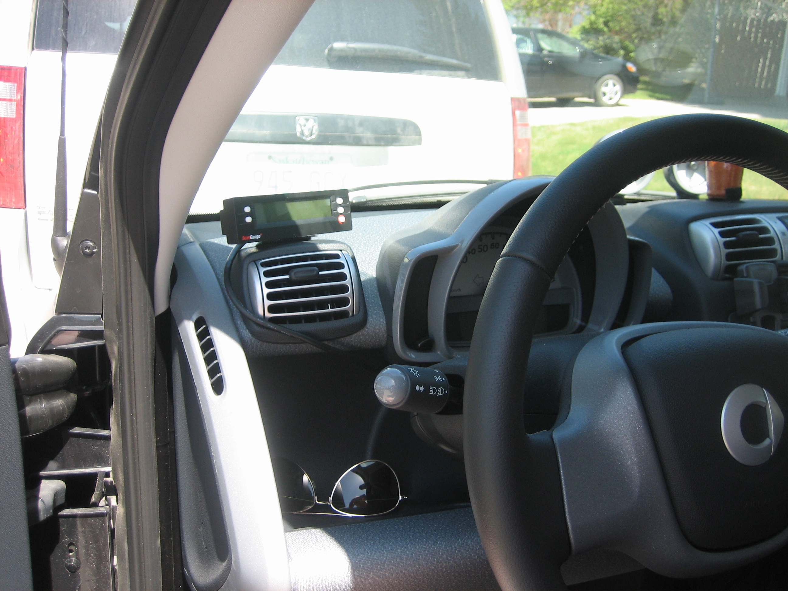

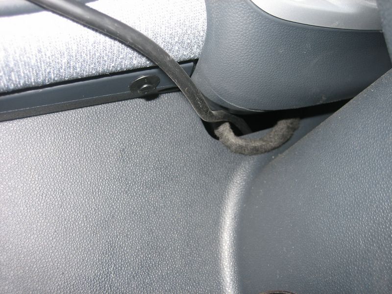

brahmy Posted May 18, 2008 Posted May 18, 2008 Tom P - just finished setting mine up the same as yours! I was happy to discover there was no drilling required as I want to keep my smart as "stock" as possible!To follow up on this post - the hanging velco tape solution sucked! I routed my ScanGauge cable through the dash (no drilling required, but long, slender fingers are an asset) and set it up on the left-most heat vent. Perfect spot, no vision obstruction, and I don't have to peek through the steering wheel to see it! Close-up of where you can route the cable through in the driver's side cubby. Quote

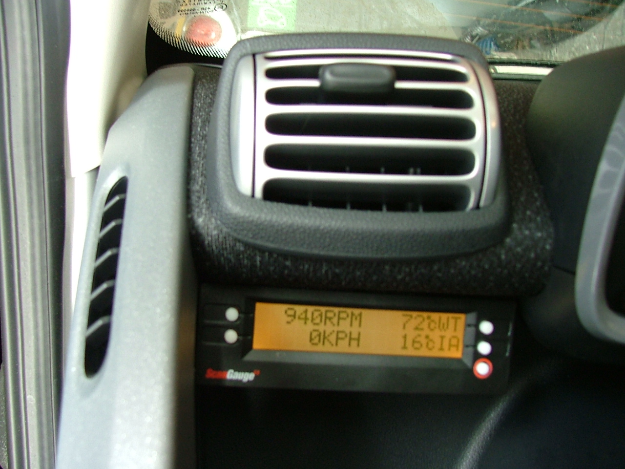

Guest cubefx Posted May 22, 2008 Posted May 22, 2008 Here is my Scangauge II installation in 451 CUBE Quote
Duck Posted May 22, 2008 Posted May 22, 2008 Looks fantastic! Any details/photos on how you mounted it?-Iain Quote
Guest cubefx Posted May 22, 2008 Posted May 22, 2008 Iain, I have DIY on Smartcarofamerica. http://www.smartcarofamerica.com/forums/sm...ok-install.html CUBE Quote
