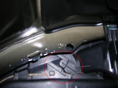

Guest gazzalama Posted March 3, 2008 Posted March 3, 2008 (edited) Hello everyone, I'm marco from como, italy and I just joined this club. Last friday I mounted a pair of tweeters to my new smart 451 and I just wish to suggest this to everyone who has the standard speakers (and radio 9) since it improves the sound quite a lot. There is a space where to clip the tweeters under the dashboard (see pic enclosed) they must be between 29 and 34 mm diameter and the cables are already fitted and they can be easily found also under the dashboard, even if in the driver side I had to remove the fuse box to find it. My choice was a pair of Sony XS-H03 which I paid only 30 euros. The sound is improved even because the door speakers are midwoofers, so with the tweeters now you can listen to music, even if it remains quite poor compared to the sound system of the previous version, with the extra sub and tweeters. Does anybody know the electric scheme of the Radio 9? This is because I would like to plug the iPod cable, but the connections scheme of the radio 9 is different than the one of the past smart version... Before it needed to be connected to the blue ISO plug, but it doesn't work with the radio 9. Edited March 3, 2008 by gazzalama Quote
