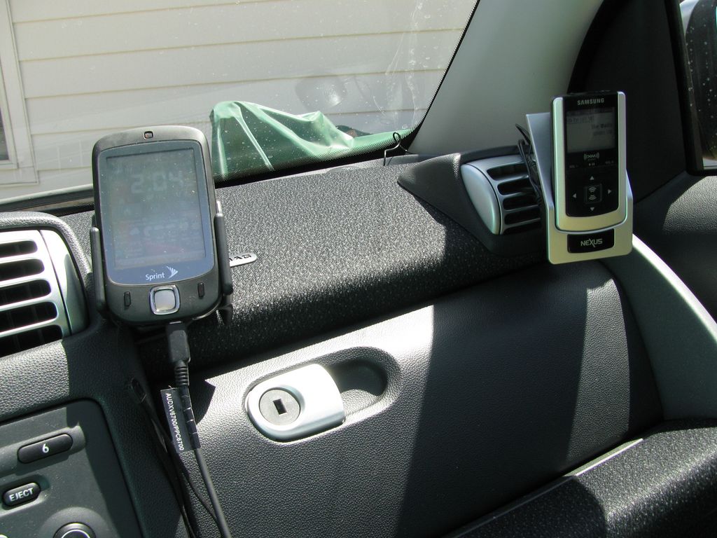

Sooner or later I'll have everything I want in this car - this morning the ProClip holder (http://www.proclipusa.com) came in, and I was able to mount my phone. The fit is not quite as good as some of the other ProClip holders I've had, but it definitely will stay put and can be removed with no sign that it's ever been there at all. I decided to just use a vent mount with the xm radio. I'm using a 2' antenna and so far haven't had any problems with signal even though it's just laying up in the corner of the dash. The power cord runs down the rubber gasket at the front of the passenger side door and then into a 3-outlet power supply I mounted with velcro underneath the glove compartment. It barely shows unless you're really looking for it. The phone, a bt gps receiver, and the xm radio are all plugged into it. The phone cord is the only one that's visible, but since I only have the phone mounted there when I'm using gps it doesn't bother me. Here's a picture (and I really need to wash the windows!).
