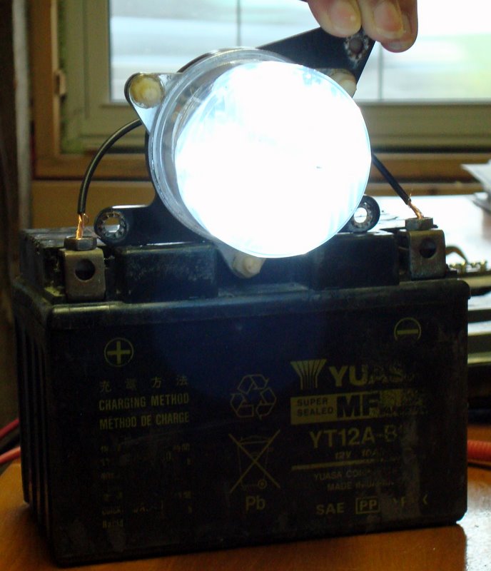

booneylander Posted September 13, 2008 Posted September 13, 2008 Hey guys.Have been fiddling with my little guy this past week in an effort to get some decent LED-based driving lights going on. Here's what I did:-Moved the turn signals back into the "euro" location within the leadlights.-Bought some bulk LEDs off of eBay.-Filled the "fog light" housings with the LEDs (20 of them).-Filled the housing with clear silicon to weatherproof/insulate all the connections etc.Here's the result after doing one housing: Quote
booneylander Posted September 13, 2008 Posted September 13, 2008 The LEDs have a Vf of about 3.6V, so by running 4 LEDs in series you can do away with any resistors. So I made bundles of 4 LEDS in series, put 5 bundles in the housing and then ran all the bundles in parallel. I'm planning to do a How-To with more pics when I build the second "fog light" but I wanted to post this up just for a taste. This fog was pretty bright last night in the dark but this morning in the daylight it wasn't powerful enough to make a pattern on the floor/wall so we will see once they are installed if they are bright enough in the daytime to serve as DRLs. I was pretty disappointed in the LEDs I got. Like a lot of things on eBay the LEDs were falsely advertised. They said these should have been 140 000mcd and have a forward current of about 20mA each. When I tested the LEDs on the bench with the resistor they supplied it was more like 1mA and with the whole assembly of 20 LEDs it was still only pulling about 20mA. I also have some 5mm LEDs that I got a long time ago and are rated at 5000mcd, and these 10mm ones, while brighter, are only marginally so. I think if you really want a quantity of light that can compete with a traditional bulb the only way to go will be the high powered SMDs with heat sinks. Unfortunately the cost of these is way higher than the bulk LEDs like what I got. Quote
