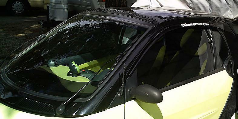

bilgladstone Posted May 28, 2010 Posted May 28, 2010 Added new decals: Though I think I am going to very carefully razor out the chicken beak to make it more legible.Bil Quote

gordo.bernard Posted June 11, 2010 Posted June 11, 2010 OTBill, do you have vortex generators at the back of the roof as well? Quote
bilgladstone Posted June 11, 2010 Posted June 11, 2010 OT Bill, do you have vortex generators at the back of the roof as well? Not at this time. I am chasing principles from aeronautical applications and attaching VGs at about 10cm ahead of the high point of the cross-section in order to "drag" the laminar flow down to the following (roof) surface. Next little VG project is to do the same under the chin, to clean the flow up onto the under-tray surface (and into the fuel cooler and intercooler scoop).This long-term "sandboxing" here at the Skunkworx Bil Quote
