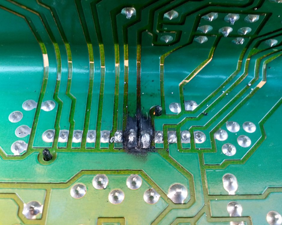

Alex Posted July 23, 2013 Author Posted July 23, 2013 The problem is the plug connection. A little too small for continuous high draw like lights or fuel pump. A little resistance causes heat, and it goes worse from there. The melted plastic and burnt pins are proof. The heat in the later stages of failure can be conducted into the board and show damage, but that is secondary damage. It may need repair, but it isn't the problem. My repair method by soldering a new wire directly to the board is by far the best way to repair a failed connection. Once the damage is done the pin is in such bad shape that a new plug doesn't have a chance. "Replacement repair harnesses are available, but once the connection has failed the pin on the SAM is usually heavily damaged and will not make for a lasting repair." "When a connector goes bad like that it ruins the surface finish of the pin as well, and a lasting repair is unlikely by just changing the connector end." Told ya! Quote

Alex Posted July 1, 2014 Author Posted July 1, 2014 (edited) Update: After more thought and discussion on other threads I've come to the conclusion that unless the damage is terminal the best solution is to clean up the pins and connector as best possible and install external relays to take the load off both the connection and the hard-to-replace onboard relay. More reports are coming of the onboard stock relay failing. Not surprising, I looked at the specs and it is pretty much maxed out on capacity, it's a smallish relay. The high draw almost always on circuits are too much for long life.(More to come as an edit in this space. Not yet. I have a new failure (it being the relay for the intercooler fan), I'll be repairing again or replacing my SAM, and will document a nice relay bank install job and post here.) Edited July 1, 2014 by Alex Quote

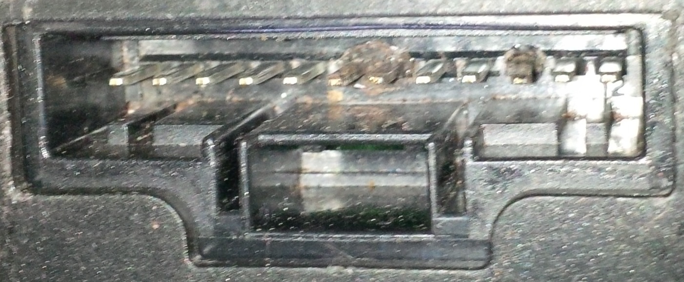

BackInTown Posted October 21, 2014 Posted October 21, 2014 Maybe pins 6 and 7 of SAM connector N11-3 melt-out because of a faulty headlight motor? Headlight motor should be linked to the same wire of main lights and if they become faulty they never find the right position and start going up and down, making a lot of noise and requiring more amperage. Probably that could melt the SAM connector... Does anyone who had this SAM connector issue also had a faulty headlight motor? 1 Quote
dmoonen Posted October 21, 2014 Posted October 21, 2014 The load on the wire and the connection is too much and maintly for the fuel pump and headlight. Installing a relay would take the load off it saving the connection and SAM as discussed many times. Quote

smartdriver Posted April 13, 2017 Posted April 13, 2017 (edited) 5 hours ago, cadillacman said: but on another note ... what is with the pins in N11-8.16 that leads them to fail !? On my SAM I had severe water incursion which damaged the PC board but that I was able to fix. Some time later I had other symptoms which examination revealed to be from severe corrosion on the connector pins. In my car I had a failing 12 V battery which I would have to recharge from time to time and my feeling was that Sulphuric acid fumes from the battery along with the presence of moisture were eating away the pins. The stock battery is supposed to be vented to the outside world with a tube placed through a hole in the chassis, but mine wasn't. After replacing and cleaning the most affected pins, before re-inserting the cable harness connectors, I sprayed the pins with Lithium Grease as a protector and after putting the SAM back in place forced a sponge on top of the wiring harness above the SAM to collect any possibility of water, likely from a leaking windshield or possibly air conditioning condensation, wicking down the cables into the connectors. This was 3 years ago and I have had no issues since even though my car has been parked outside for this length of time. Edited April 13, 2017 by smartdriver Quote

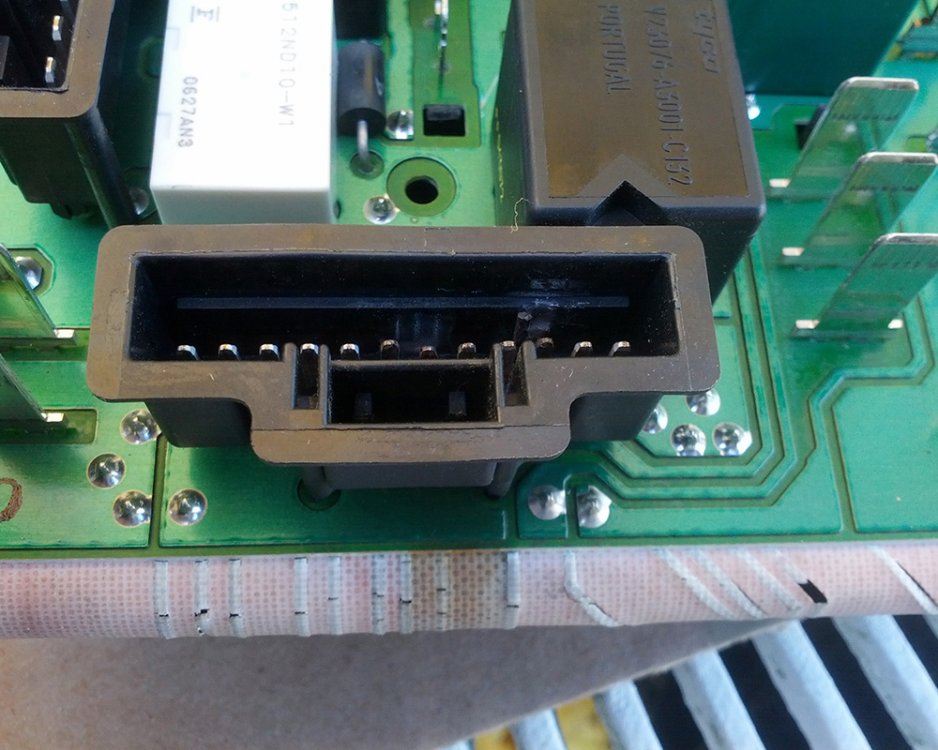

miker Posted November 3, 2018 Posted November 3, 2018 Well, the fix on the fuel pump has lasted 6 years, but it's time for me to dive into the SAM again as (as Alex predicted) the headlights are going out. So far it's just the high and low passenger side. I'm hoping this is pins 6 & 8 - right side low and high beams? Hopefully the orientation is from within the car rather than from in front of it facing the rear. Now that I have the SAM out again, there really isn't a lot of room to solder. Here's hoping I can get the soldering done with my eyes 6 years older and hands 6 years less steady. Quote
Thegorillabear Posted November 23, 2018 Posted November 23, 2018 I had issues with my headlights too and it was the N11-3 plug as pictured above. I went to Mercedes and got a new pigtale as described by https://www.evilution.co.uk/index.php?menu=electrical&mod=844 and put in stock bulbs I looked at the solder points on the board but they looked ok to me. I put it all back together, swapped the wiring over and rocked on.... for about 2 months. Then it all happened again. This time I went the route that Jerzy has followed with a few exceptions. I didn't go to a an auto wrecker for a plug. I ended up deciding to us a little over kill and got a Mil style 12 Pin connector from a local electrical shop. These pins have the ability to withstand more issues with heat I have the eyes of a middle aged guy with the fine motor skills of a middle aged guy with arthritic monkey claws. So I took the SAM to a local computer repair shop, opened it up and they did all the soldering for the wires, and put a significant amount of special stuff that looks like hot glue to keep them from flexing at the board and breaking. I made sure that the connector had enough wire at both ends and it now sits below the SAM with Velcro to keep it from moving around. Quote
miker Posted October 6, 2019 Posted October 6, 2019 On 03/11/2018 at 2:01 PM, miker said: Well, the fix on the fuel pump has lasted 6 years, but it's time for me to dive into the SAM again as (as Alex predicted) the headlights are going out. So far it's just the high and low passenger side. I'm hoping this is pins 6 & 8 - right side low and high beams? Hopefully the orientation is from within the car rather than from in front of it facing the rear. Now that I have the SAM out again, there really isn't a lot of room to solder. Here's hoping I can get the soldering done with my eyes 6 years older and hands 6 years less steady. I got a kid taking an electronics course to do the soldering for me. Everything worked perfectly until recently (see my thread about canbus error) and it seems that taking the SAM apart and cleaning all of the contacts has it back in order again. 1 Quote
