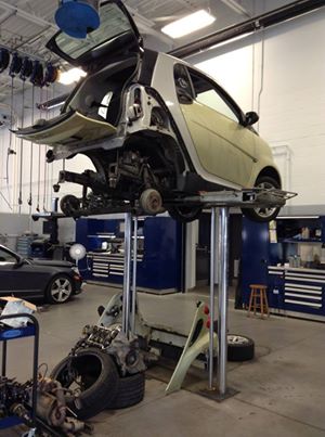

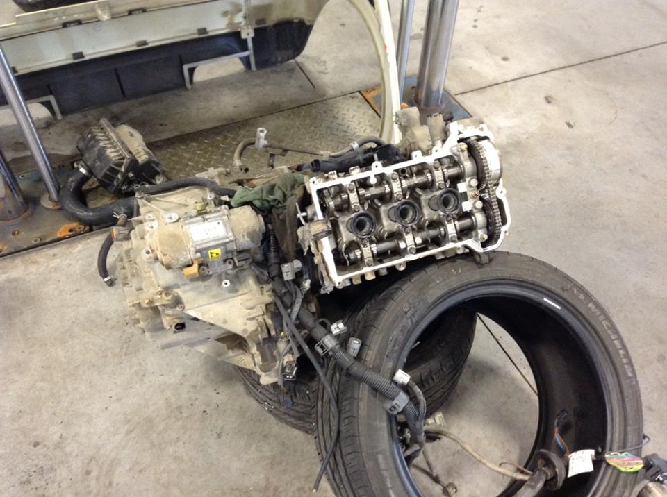

adelaide J Posted July 6, 2013 Posted July 6, 2013 Had a P303 code appearing on the scangauge so off to MB London to find a bad exhaust valve on no#3 cylinder. I have 87000Km on the car. Has anyone else had this problem with there car. My is a 2009 Quote
Huronlad Posted July 6, 2013 Posted July 6, 2013 There are discussions on sCOA about valves fouling up and failing. Some are using fuel additives to combat the problem with some success IIRC.What fuel do you use? Quote
adelaide J Posted July 7, 2013 Author Posted July 7, 2013 Some shell, but mostly esso91. I tried run seafoam threw a couple of tanks but the damage was already done.Car seem to run okay going to work and back, but if I started it when jt was at temperature it would throw a misfire on #3 cylinder. First time I had this was in April in Ohio and thought I was into some poor gas. Only have 50lbs compression in #3 Quote
adelaide J Posted July 18, 2013 Author Posted July 18, 2013 Just got a reply from MBLondon. They are going to supply me a rebuilt motor free with exchange for my motor with a bad valve and worn cylinders. I have to cover the labour so I should have on the road for the Mistery Run Quote

adelaide J Posted July 20, 2013 Author Posted July 20, 2013 I was told told that the cylinders show excessive wear for 87000kms. Too bad I didn,t get some pictures Quote
