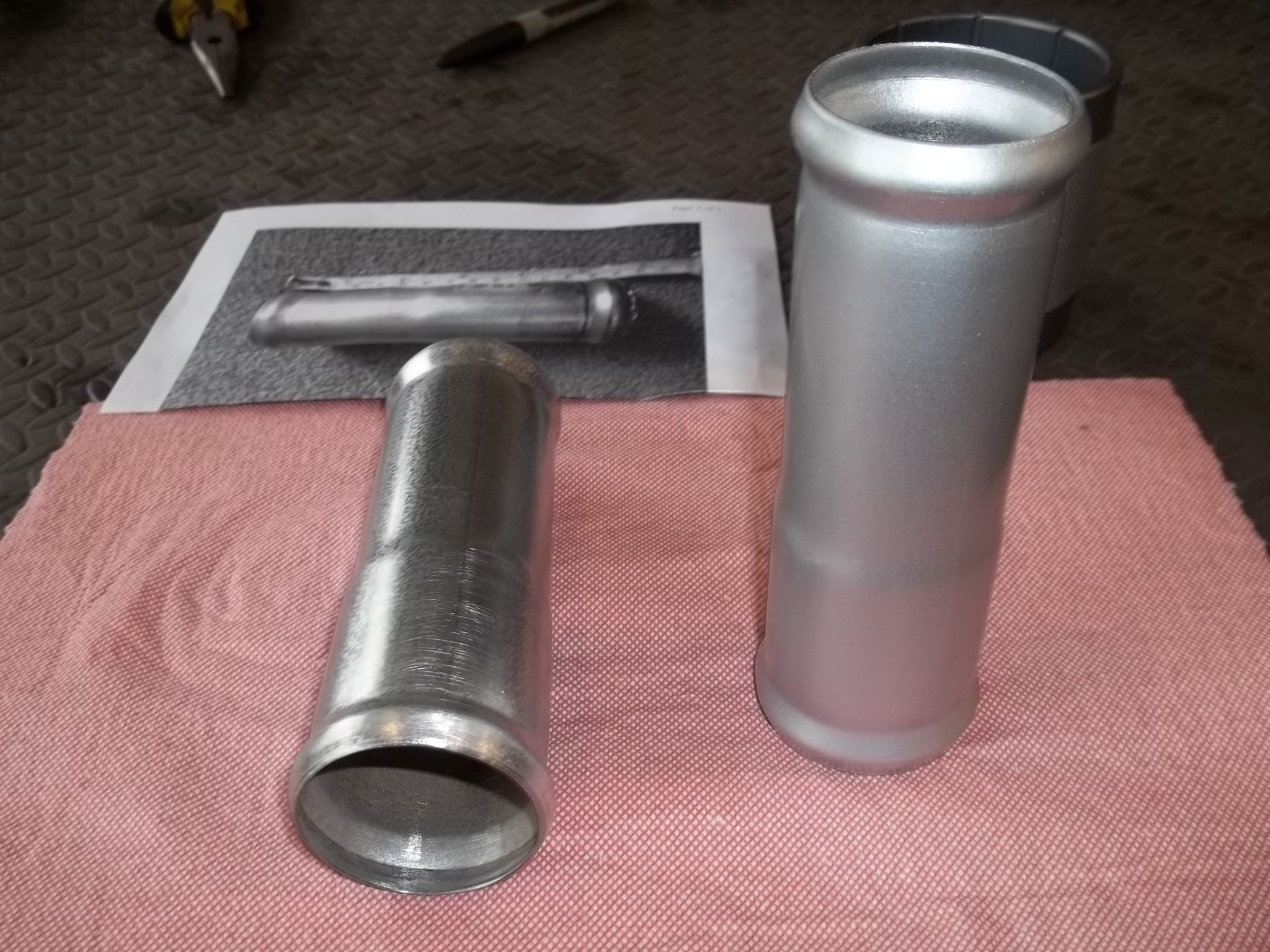

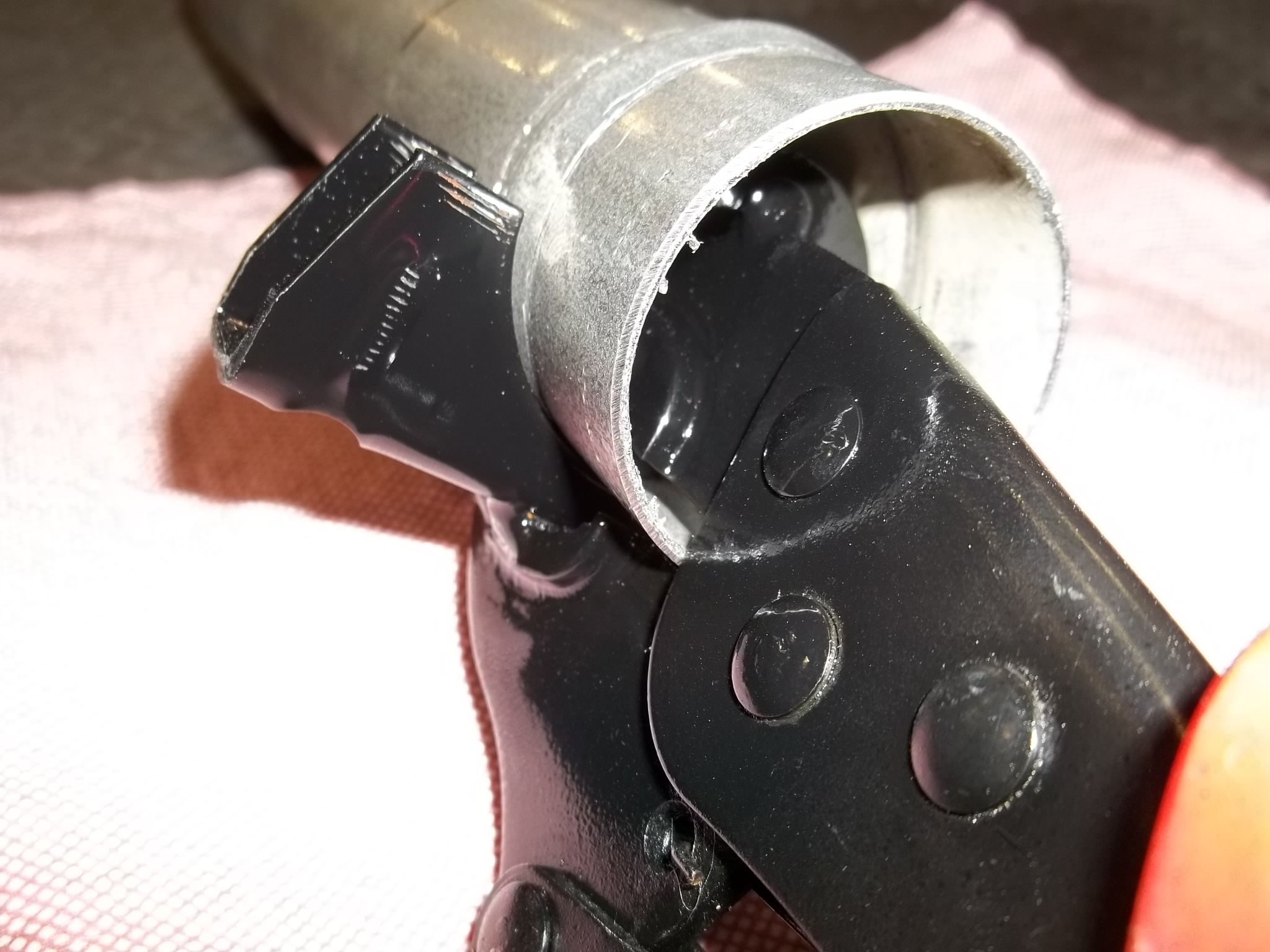

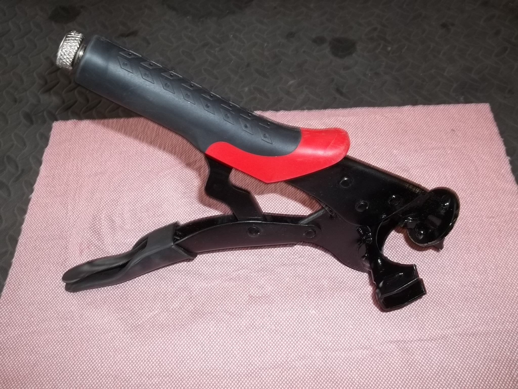

turbomar Posted September 21, 2013 Author Posted September 21, 2013 (edited) I'm not that desperate to replace the EGR just yet. It'll be a while yet before I have the time to actually replace it anyway.I made 2 Intercooler to Intake pipes today. I'm in Kanata tomorrow Max if you want to take delivery.Thanks Stickman007 for the measurements and tool idea. I bought the plyers at Dollarama for $2. The pipe on the right is spray painted with silver caliper paint I had left Edited September 21, 2013 by turbomar Quote
stickman007 Posted September 21, 2013 Posted September 21, 2013 (edited) Thanks! I wished that I could claim the plier beader idea, but I got it from another forum while researching for a tool. The pipe idea came from Bilgladstone.You pipe looks really nice! much nicer than the one that I made. Excellent Job! Nice pics! Edited September 21, 2013 by stickman007 Quote
FlossyTheSmart Posted September 21, 2013 Posted September 21, 2013 Wow, yeah, that turned out really nicely. I'm honestly kind of surprised that they had vice grips at Dollarama, but you never know what you'll find there!And yes, I'd love to grab one tomorrow. PM me and we can talk where and when. Quote
turbomar Posted September 22, 2013 Author Posted September 22, 2013 (edited) Yes, I give credit to Bilgladstone as well. This tool is a must for any fabricator. Once I saw what it could do, I had to have one. Forums are the best for money saving advise and idea sharing, not mentioning meeting great pplPM sent, see you later Max Edited September 22, 2013 by turbomar Quote
