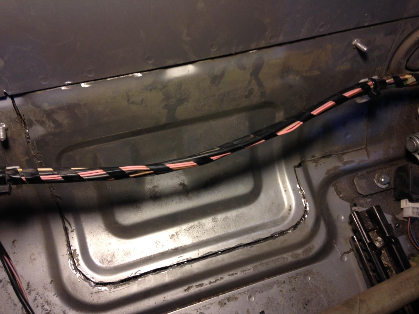

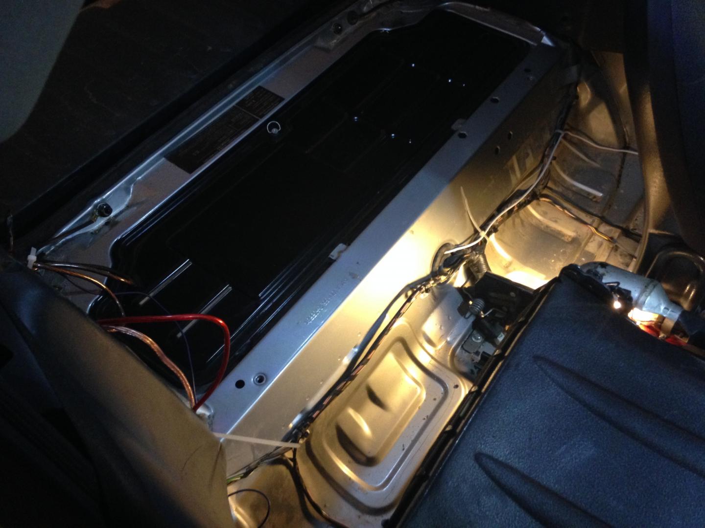

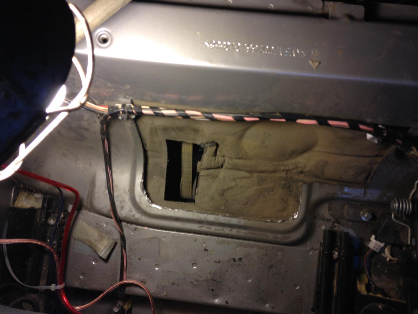

shcubbebah Posted February 24, 2015 Author Posted February 24, 2015 ok everyone I managed to complete the task. I have many pictures of my progress so I will make several posts so bare with me. I made some cuts in and around the seats in the carpet to make it easily removed without seat removal. will also assist when working under hood anyways as the carpet flap tends to get in the way. I then marked my lines and cut the opening once I removed the panel I had my insulation in my way so I just cut it out. Quote

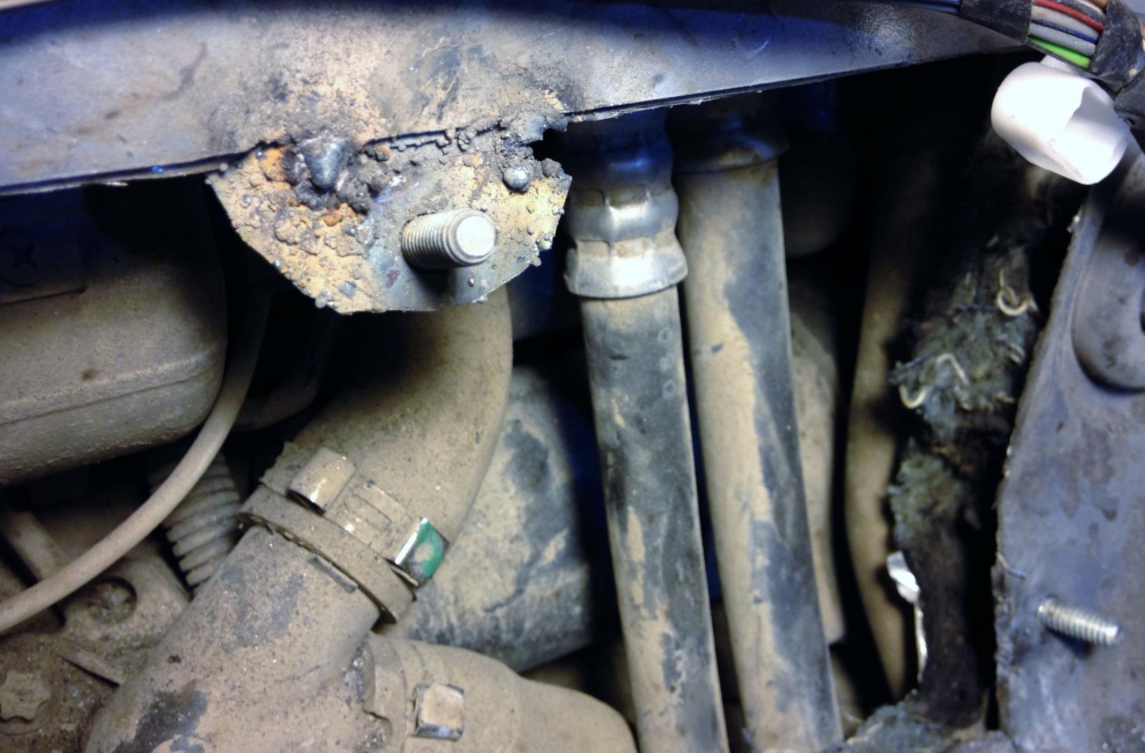

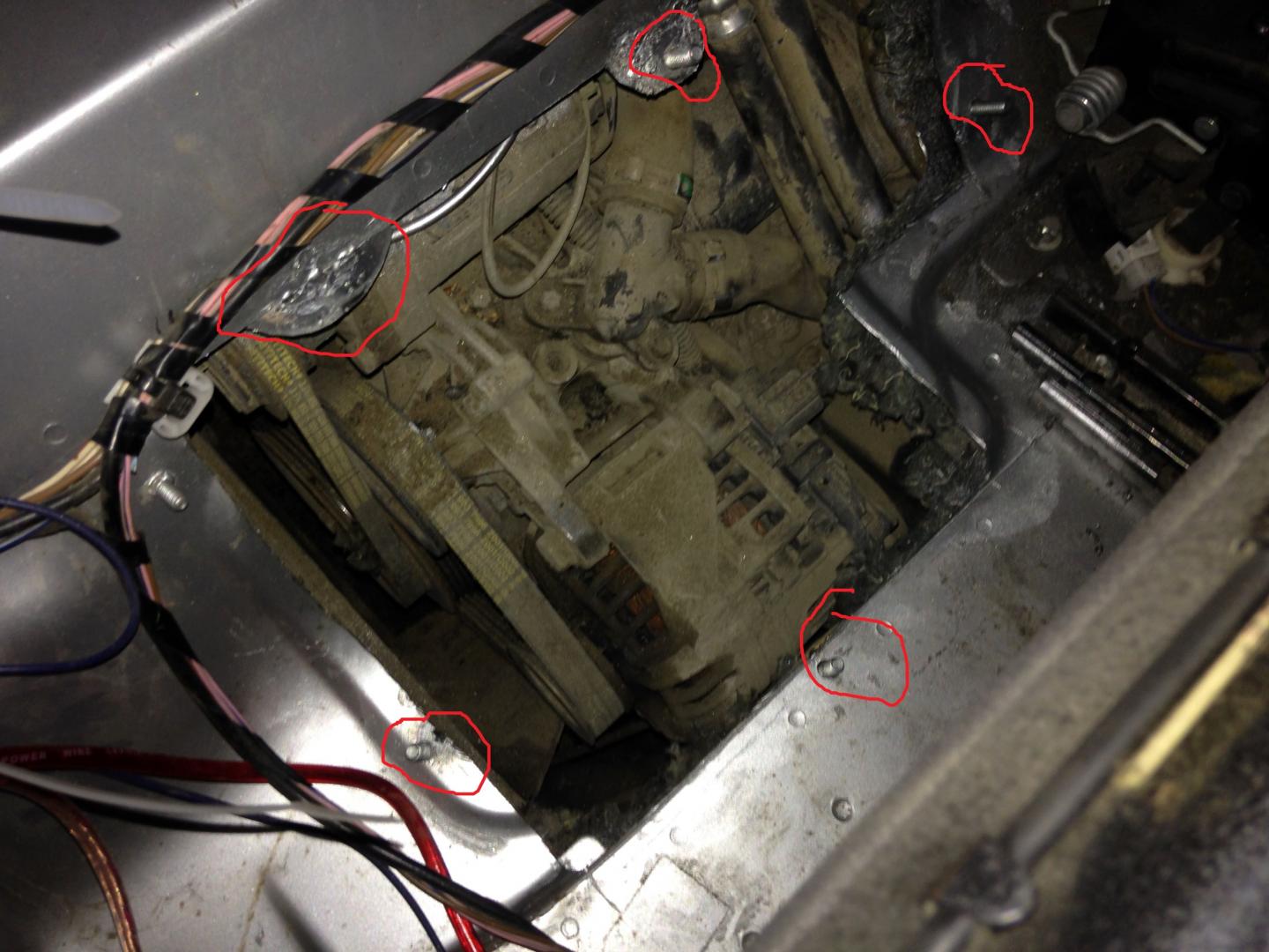

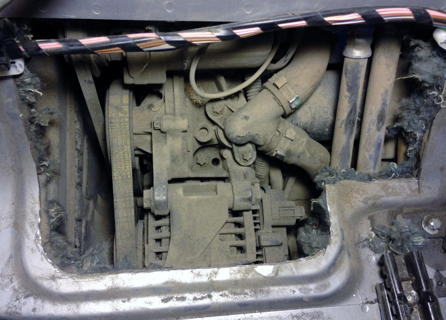

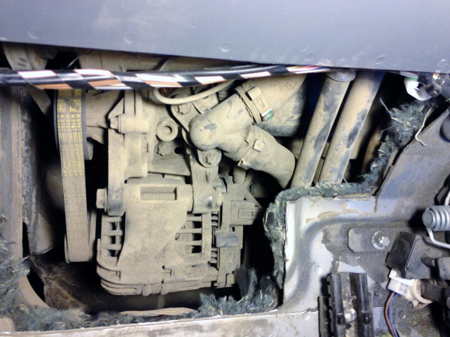

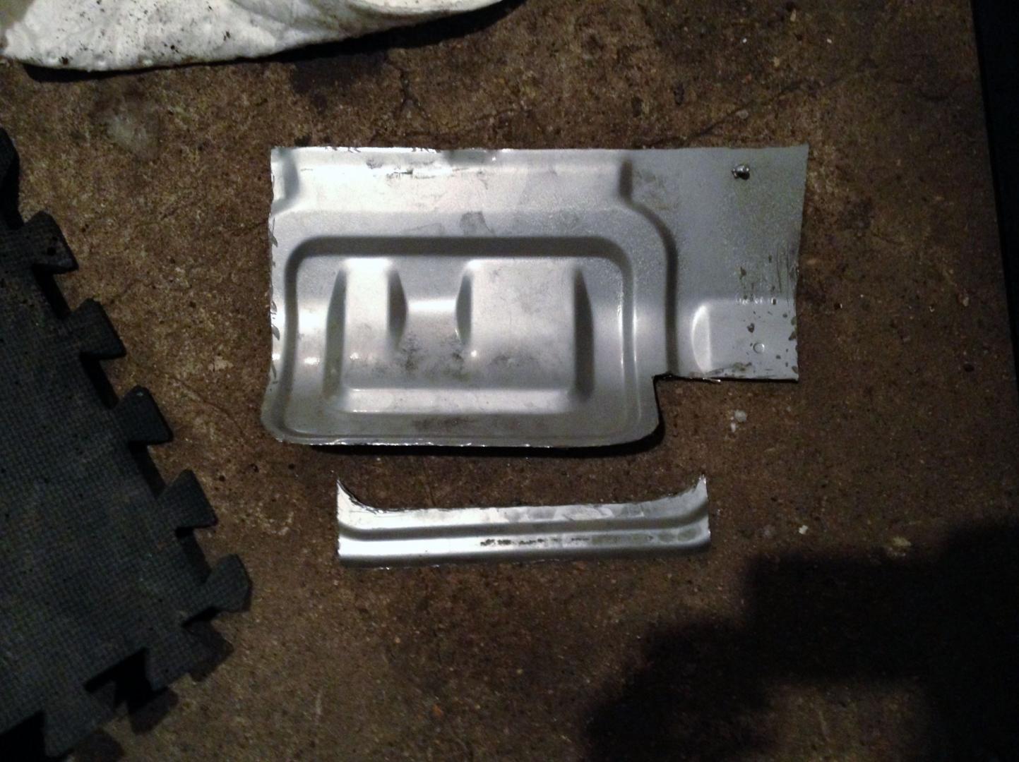

shcubbebah Posted February 24, 2015 Author Posted February 24, 2015 after I removed the insulation I quickly realized my hole wasn't large enough In the bottom portion to provide adequate clearance to remove the alternator. I then cut my hole larger and was left with two pieces. ( a mistake on my part for not measuring properly. I now had all the room I need to access alternator. here is the piece welded.I also began adding mounting brackets I drilled some holes just outside the perimeter of the opening and welded a bolt facing inward to the body( lower right of picture) and have it act as a stud. make sure you remove your insulation before this step. also I made plates on the top to help the panel seat in the correct spot (top) these are all final studs and brackets sorry my skills in paint aren't sufficient Quote

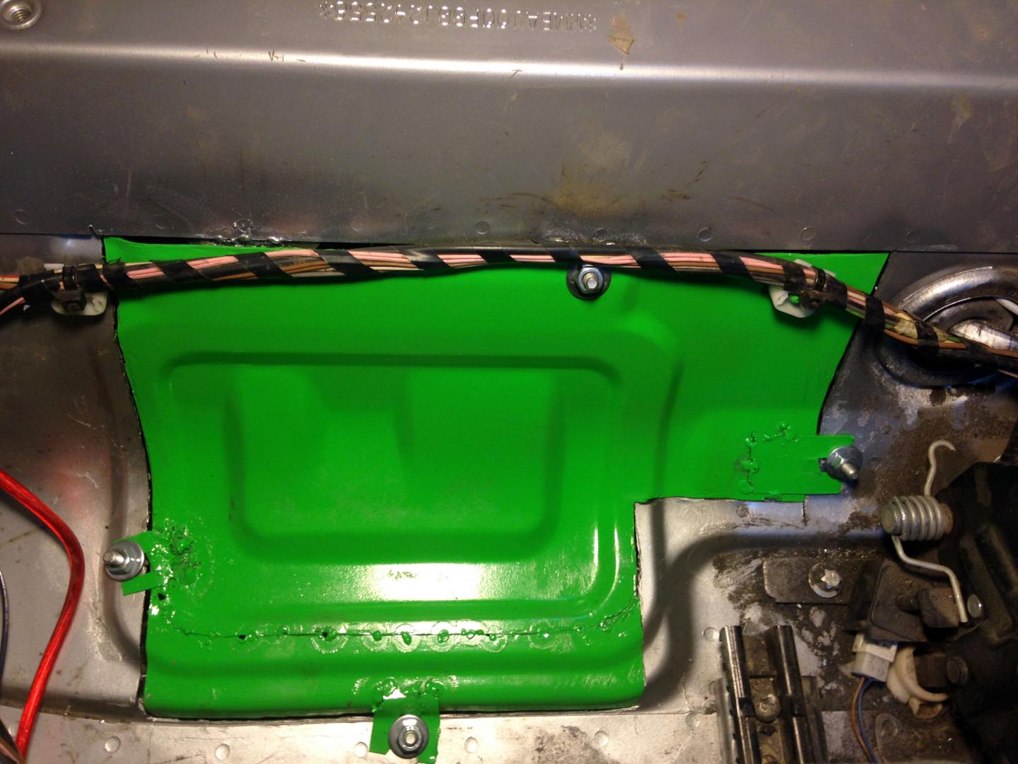

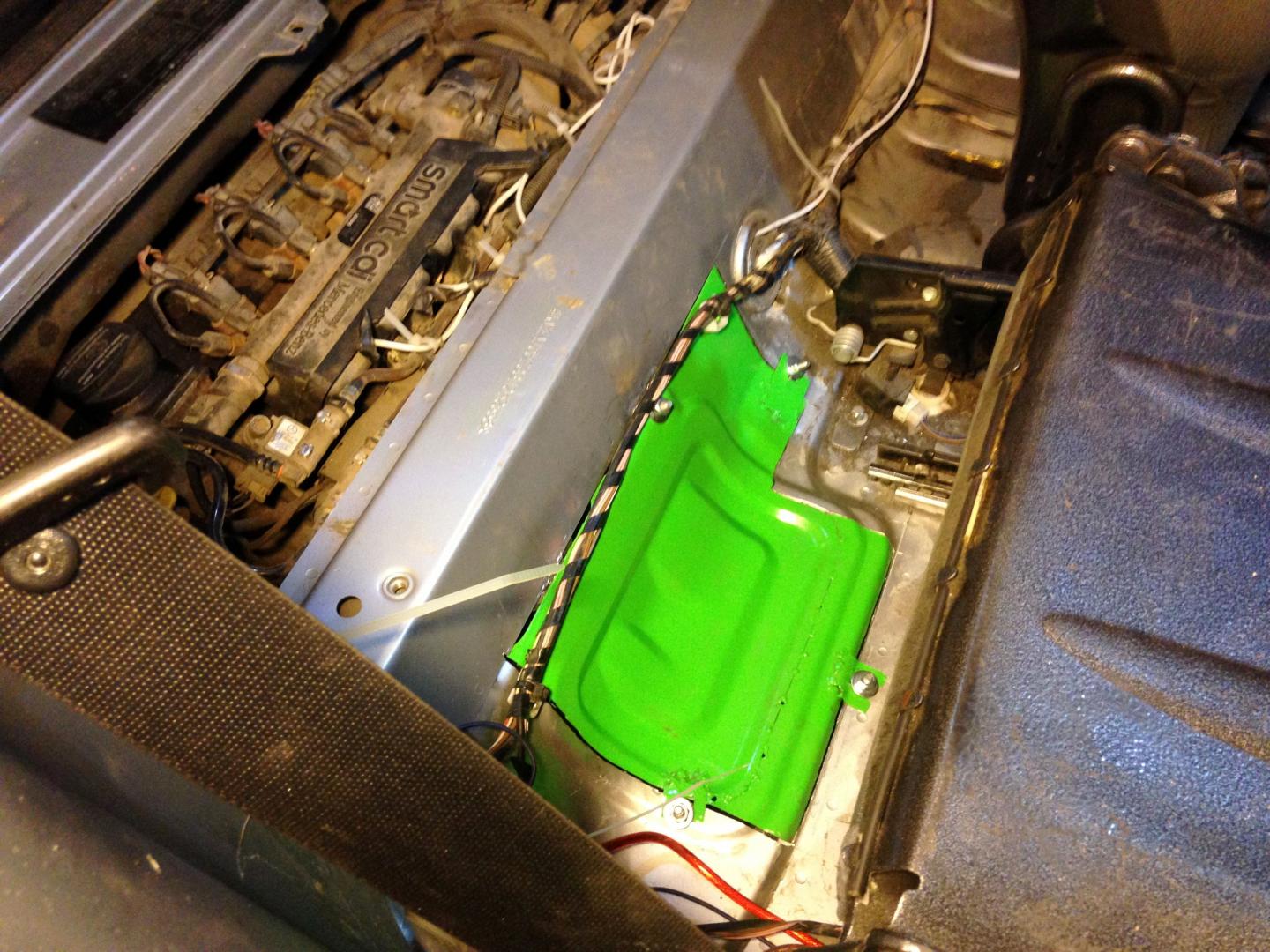

shcubbebah Posted February 24, 2015 Author Posted February 24, 2015 I now painted the exposed edges to prevent corrosion on the car silver and thought I might go with a wild green color for the access panel. I fitted it in places and its is a perfect fit. the only addition I want to make is ad weather stripping to edges of the car itself to remove jagged edges and create a seal when panel is in place, however I was unable to locate the slip on type that you would see around the door on your vehicle. as you may see there is a minimal gap around the panel. that should be fixed by just adding the weather stripping. I then placed my carpet back in the vehicle and went for a test drive and even with out a seal the carpet is enough to block all engine noise. and its just as quiet as before the mod. I hope I might inspire others to do the same. it was a very easy job if you have a die grinder with a cut off wheel at access and a welder. took me 3 hours total time once I came up with the design. which I believe was a great investment for my time for the outcome. let me know if there are any questions I may not have answered I tried to be very though out. I am now just awaiting postage of my restrictor that I will be installing and will have immediate access to the V-pipe needed to install. Quote
CANMAN Posted February 24, 2015 Posted February 24, 2015 For a seal you can buy vacuum hose at Canadian Tire then slit it lengthwise and install over the edge. You can probably glue the insulation back onto the outside of your hatch using contact cement. It's great that you shared your mod with everyone so we can all benefit from your experience. However for every helpful suggestion there will also be criticism. If I were ever to do this mod, I would lower the engine and remove the insulation first, you are lucky the sparks from the grinder didn't set the insulation on fire, and your car and garage. Canman 1 Quote
tolsen Posted February 24, 2015 Posted February 24, 2015 Great mod. Automotive window sealant mastic will suffice. Doubt you will need to make use of the hatch more than once a year at the most. Quote

shcubbebah Posted February 25, 2015 Author Posted February 25, 2015 (edited) I agree with canman I would make sure the insulation is removed before any cuts were made. I actually used another piece of metal ( an old license plate) to separate the insulation from the metal being cut or welded to prevent a fire. however a more profession approach would be to just remove it before hand. once I receive my restrictor I will hunt down my weather stripping and post picture of that aswell. Edited February 25, 2015 by shcubbebah Quote

shcubbebah Posted February 26, 2015 Author Posted February 26, 2015 While I appreciate the "science experiment" aspect to it, I still don't get it. the main roll of this access panel is to be able to remove my alternator without lowering engine to allow clearance. I do believe I even have access to both the mounting bolts of the alternator from top perspective (the lower will be by feel but is doable) another benefit is access to the v-pipe for restrictor mod. as for the thermostat itself and starter my hopes may be crushed slightly as I have the feeling I will still need to lower to get at them both. next time I open it up to install my seal and perform my restrictor install I will take some more pictures facing upward toward thermostat once coolant hoses are removed I may have slightly more access to thermostat mount bolts. but cannot be certain as I haven't attempted yet. Quote
