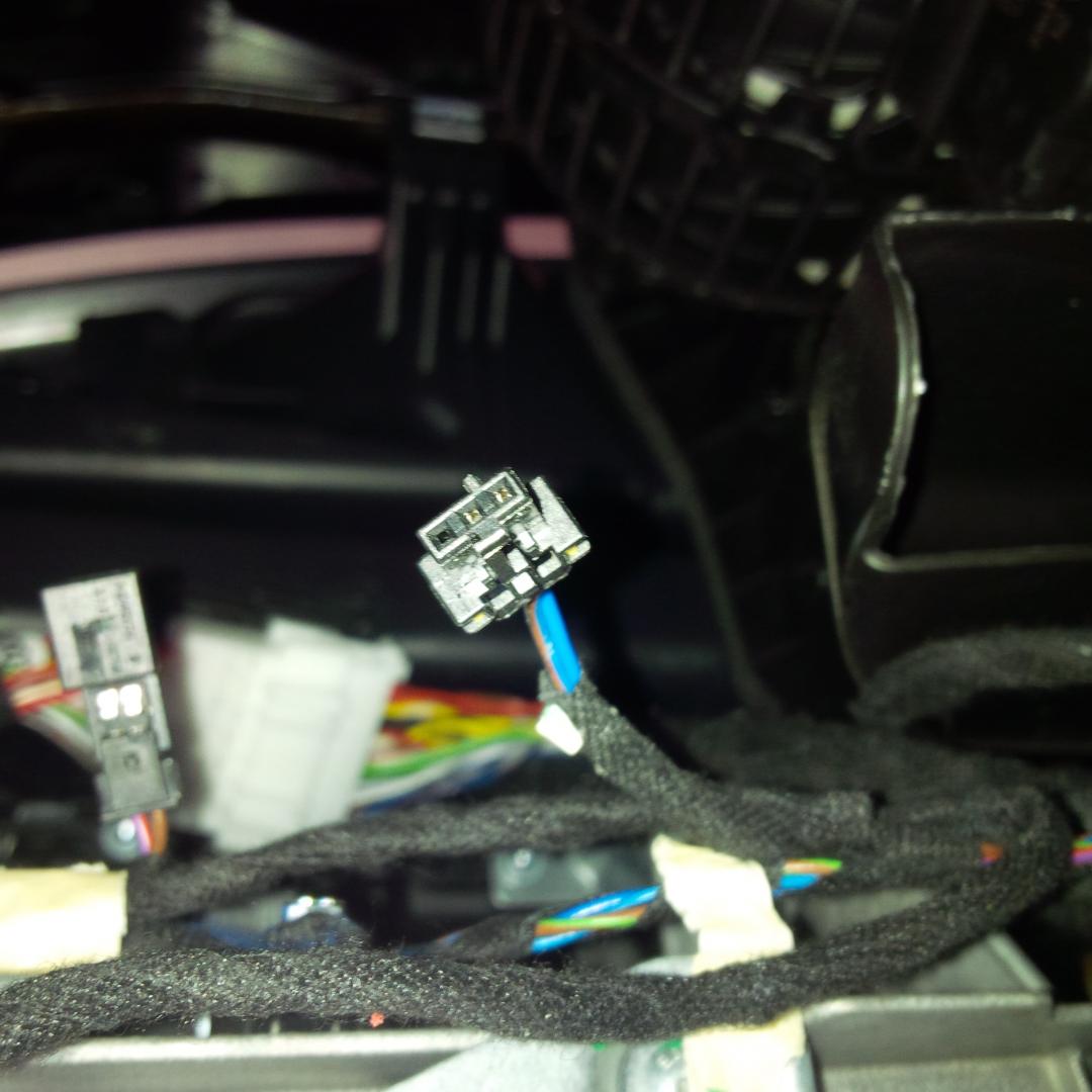

SmartEdge Posted September 10, 2015 Posted September 10, 2015 I noticed that there are some extra connectors under the driver and passenger side of the dash. I pulled one down and used a volt meter to test the leads, but nothing seemed to give them power. Headlights on/off, Dome light on/off in combination with the car running/not running. I suspect they might be pre-wiring for the ambient light package, but I'm not sure. If so, I might just be missing a fuse. Checking my fuse box I have fuses in nearly every slot. The only empty spots are R3,R4,R5, and R6 Model is 2013 City Flame with Surround, and heated seats.... and almost 100,000 Km . Is anyone familiar with these connectors? Quote
FlossyTheSmart Posted September 10, 2015 Posted September 10, 2015 Assuming they ARE for the ambient lights, I think that feature has to be enabled in the SAM before they'll work. Requires a STAR machine. Quote
SmartEdge Posted September 10, 2015 Author Posted September 10, 2015 Thanks for the response.. given my lack of star power, I'll probably just leave them be. That's an impressive list of upgrades on your 450s.. I'll need to keep an eye out for Flossy while I drive through Kanata every week. Quote
FlossyTheSmart Posted September 10, 2015 Posted September 10, 2015 If you're in Kanata every week, I'd be more than happy to (at least attempt to) activate them for you! Quote
