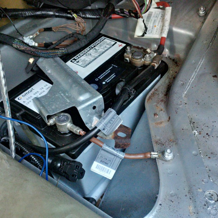

mietzesmart Posted October 18, 2016 Author Posted October 18, 2016 (edited) Here are pictures of the battery corrosion I mentioned Edited October 18, 2016 by mietzesmart replace picture Quote
tolsen Posted October 19, 2016 Posted October 19, 2016 Sort out your battery support clamp as soon as possible. Quote
Wild! Posted October 19, 2016 Posted October 19, 2016 (edited) What is the voltage on the battery when the car is running? It should around 14v - 14.75v. If it is 12-5 to 13v check the positive wire around the starter and just above it to the alternator for corrosion on the wire, that might the problem. Also check the ground from engine the to frame. the above picture the battery looks fine the battery bracket has rusted due to something else, for the bracket find some one with a nut anchor kit or buy one that will fix that problem Edited October 19, 2016 by Wild! Quote
CANMAN Posted October 19, 2016 Posted October 19, 2016 Go out to the car and remove the battery hold down bracket right now! If it contacts the Positive Battery post it will short the battery to ground potentially causing a fire. As to your charging problem: On the back of the alternator the electrical connector with the green and white wires. One of them is connected to the ECU and can override the internal voltage regulator inside the alternator. I agree with wild, replace the engine ground cable at the rear of the engine, connecting the engine to the frame behind the rear crash bar. Check every ground wire in the engine bay for corrosion, main engine ground, grounds above the intercooler, small ground wire above and forward of the oil filler cap, below fuel rail. canman Quote

mietzesmart Posted October 21, 2016 Author Posted October 21, 2016 On 10/19/2016 at 7:50 PM, cadillacman said: I went to see her car ... public parking lot ... not a place to dismantle things The corrosion is a non-issue. removed the containment strap for the time being. The turbo is a mystery ... MAP is 99 ... accelerate, and it is still 99 ... 2nd gear ... still 99 ?!!? But could not remove panels for a proper looky ... MAP sensor is connected tho. The electrical ... wow ... depressing, really. Battery DateOfManufacture is 0216 ... really new. She's gonna charge it up at home, and have it 'tested' at CrappyTire. Battery does NOT deplete when the car is not running. So , likely not a battery problem ? The system voltage dropped from 10.5v to 9.4v with the car idling for about 10 min. Alternator must be toast ? Alternator not turning ? Alternator not connected correctly ? Car did sit not-running for a couple months ( clutch Fork failure ) so rusty alternator could be an issue. Will see this W-E ... we will take off rear panels to look at Alt and Turbo Here are the battery test results: Quote
