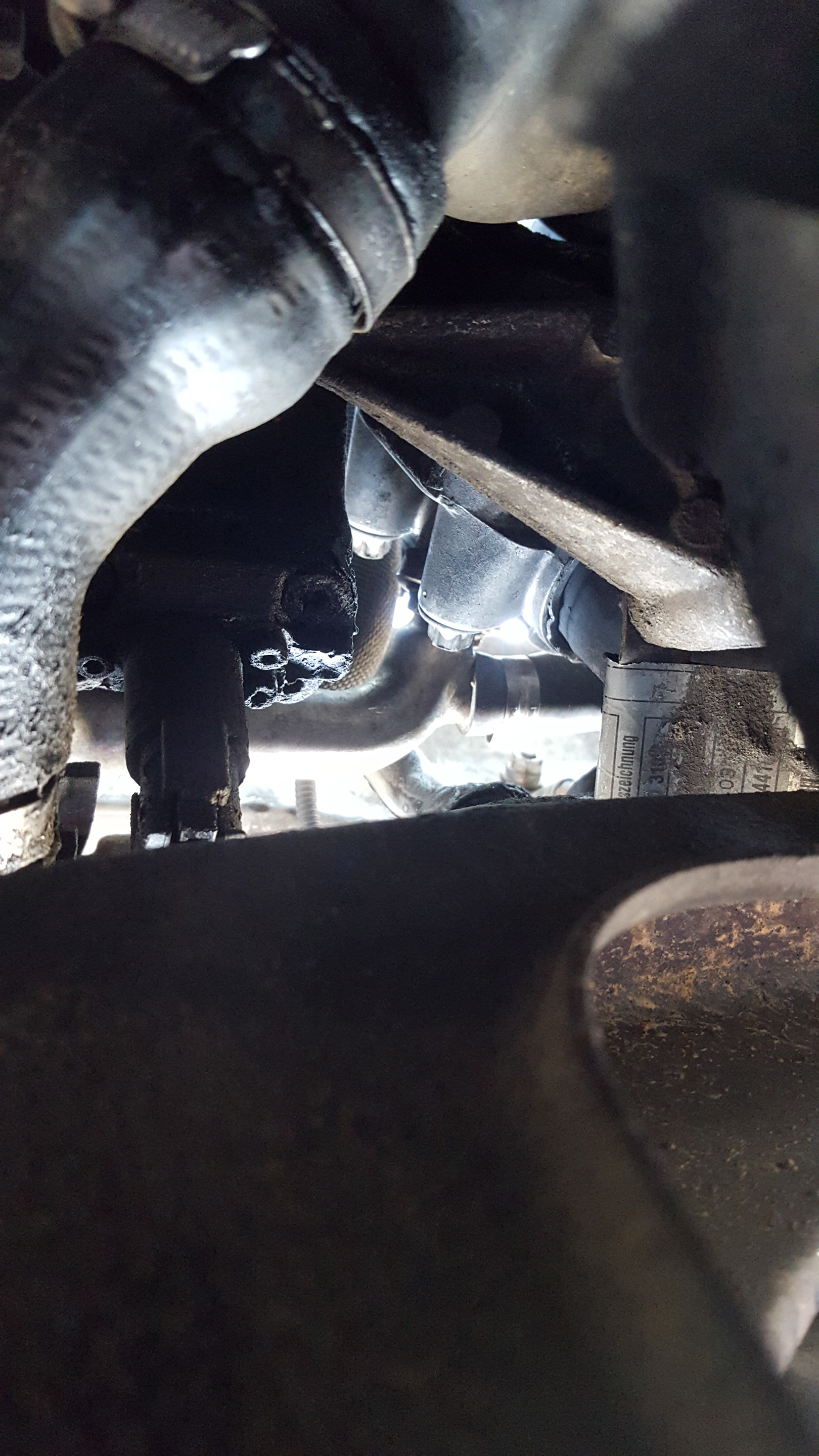

tolsen Posted December 31, 2016 Posted December 31, 2016 All Smart 450 diesels leak oil a wee bit in the area shown in your photo. Consider that as being normal. Quote
