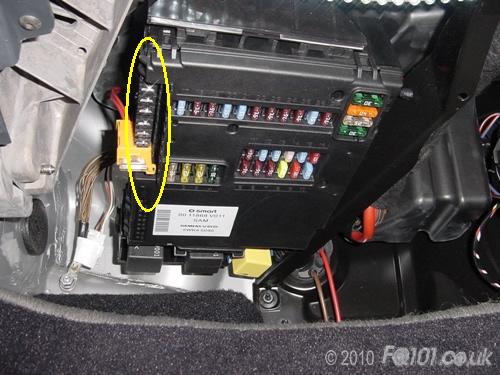

It has been a while since this happened to me, but a wire going to the SAM has likely been plugged into the wrong position.
The SAM has a bank of 9 individual fused wire connections. Five of these are always on, the remainder are key switched on.
The photo below shows where they are, but in the photo only one wire is plugged in.
In the photo, the top bank of four are switched. The bottom 5 are always on.
Edited by smartdriver
That's what it was exactly 4 wires plugged in removed 1 by 1 till found culprit works great now thanks for all your help guys
