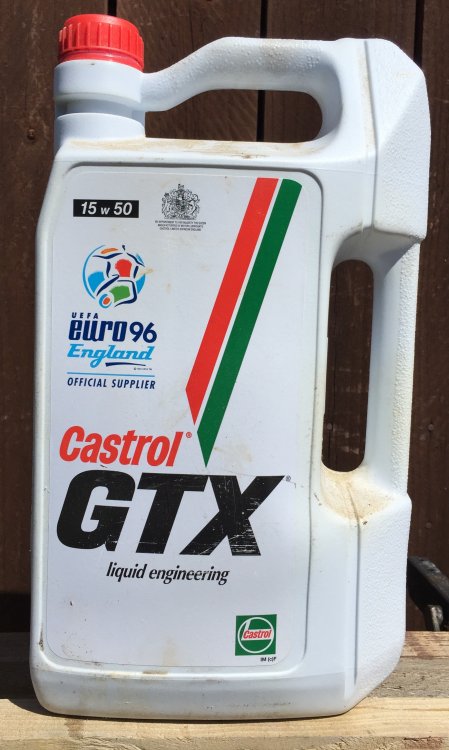

10 hours ago, tolsen said:
I am currently testing out 15w50 Castro’s GTX on my 450 diesel.
Acquired the 22+ year old oil from the garage of an elderly lady. Not Castro’s but Castrol.  Apple’s spell checker must be communist.
