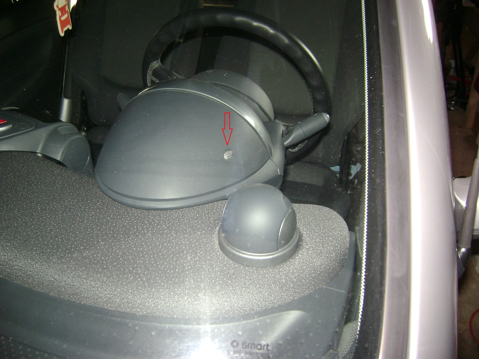

Leadwing Posted August 18, 2018 Posted August 18, 2018 1 hour ago, Toxophilite said: - Also should the radio be displaying "safe' prior to entering the code? - The engine light is on. I checked the oil, it's pretty black and it seems to be WAAAY to full, maybe 2 inches past maximum, I tested it a few times to be sure, wiping it afterwards, I'll check it again in an hour or so to let it settle. the oil is black and should probably be changed Welcome to the club! The radio is in "safe" mode to prevent thieves from stealing it and using it without the code to reset it. It (Safe mode) will also show if the battery has gone completely dead or has been unhooked for some reason. The code should be with the owner's manual and other paperwork. Engine light on...... A code reader is useful to determine the issue. The check engine light comes on for many reasons. Most are not serious. (Oxygen sensors and the like) Best to get it checked out anyway Even after a fresh oil change, the oil can go black quickly on a diesel. This is normal. If the oil LEVEL is about 2" above the maximum mark. DON'T DRIVE IT ... Drain some off. The ideal level is about 2/3rds up from the minimum mark between the minimum and maximum marks. There is a service indicator on your dash. Press the button on the left side of the instrument panel twice quickly. (see photo below) When you see it, there should be a number on it telling you how many kms. left before the next oil change is due. If is doing a countdown of numbers (29, 28, 27 etc) it is telling you how many days left until the oil change is due. If there is a negative number showing, the oil change is past due. 1 Quote

Nigel Posted August 20, 2018 Posted August 20, 2018 The single wrench is a maintenance reminder one wrench “A” service two wrenches “B” service. The minus 710 is how many km or days (I’m not sure) you are over do for a service. Oil change something like this https://www.evilution.co.uk/411 I will stay out of the additive debate except to say if you are getting diesel with biofuel mixed in already it should clean things up in a couple of tanks. Nigel Quote
MikeT Posted August 20, 2018 Posted August 20, 2018 the "-" is days service is overdue. So: two years....ugh Quote
