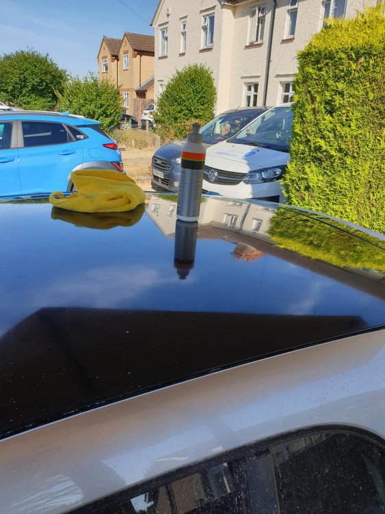

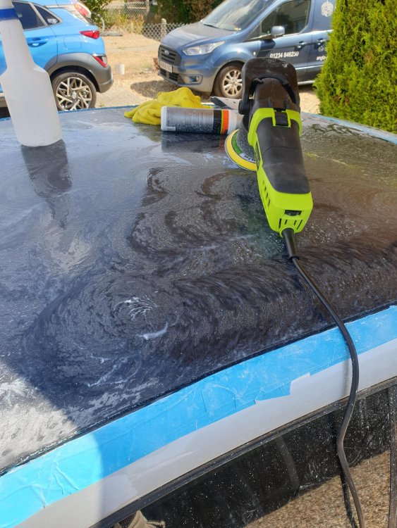

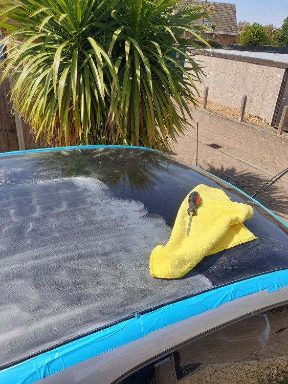

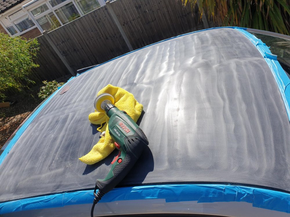

2 Days of sanding, through the grits, then compound and polishing, finished with gtechniq ceramic glass coat. .  Not a 100%, but much improved than before . ..
  • Like 3
that looks great
i hope it lasts....i suppose even if the sun gets to it again it wont need as much elbow as the first time though...probably just a quick polish each year to maintain it
