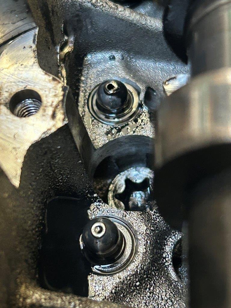

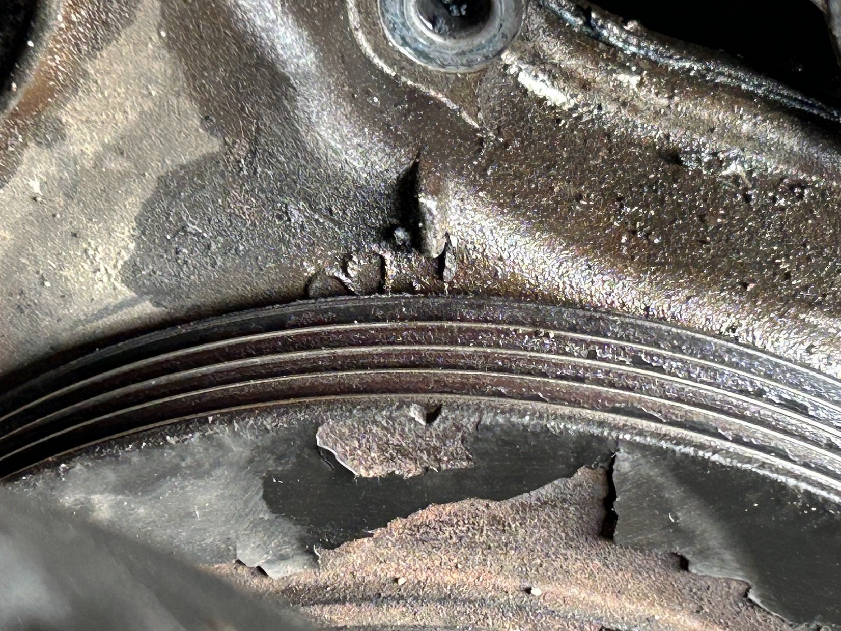

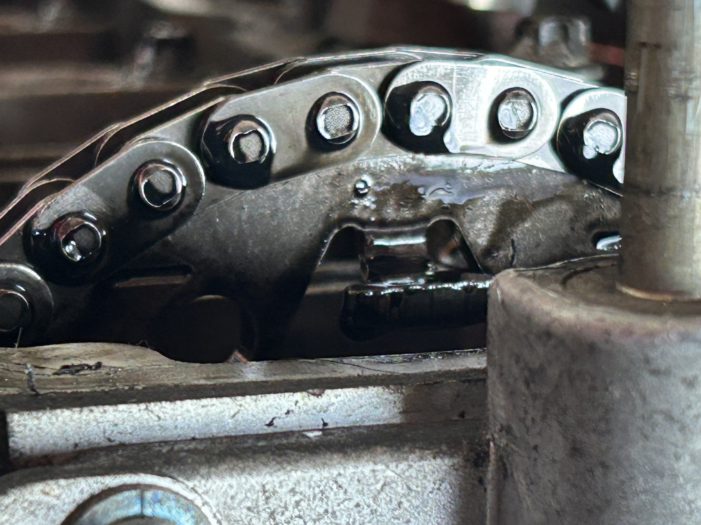

1JR1 Posted September 28, 2025 Author Posted September 28, 2025 Well, pulled the engine today and started breaking it down. Then I realized it's not a mechanical timing issue. I noticed a timing mark on the flywheel and a pulled the valve cover. Lined up the TDC mark and the cam shaft gar mark also looks good. No timing slip. Attaching photos... Now I'm wondering if there is a way to do a compression test before I break it down more. Quote

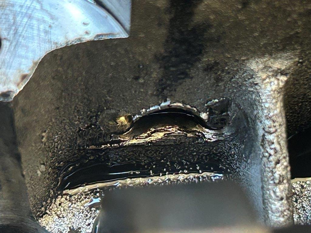

1JR1 Posted November 3, 2025 Author Posted November 3, 2025 Well I started cleaning up the motor bits to get ready for the replacement engine and found that yes the intake on #2 was open... My initial survey missed that the cam follower for #2 intake was jammed into the side of the head, out of place. See the images attached with the hole the follower burrowed into the head. This was caused by the oiler, which must be pressed into the head, compressing into the head further. This allowed play in the follower and it jumped off the oiler, wedging it's self into the head. The one picture shows a normal oiler, bottom, and the compressed one, top. The second picture is right behind the oiler, where the follower wedged it's self into the side of the head. 1 Quote
