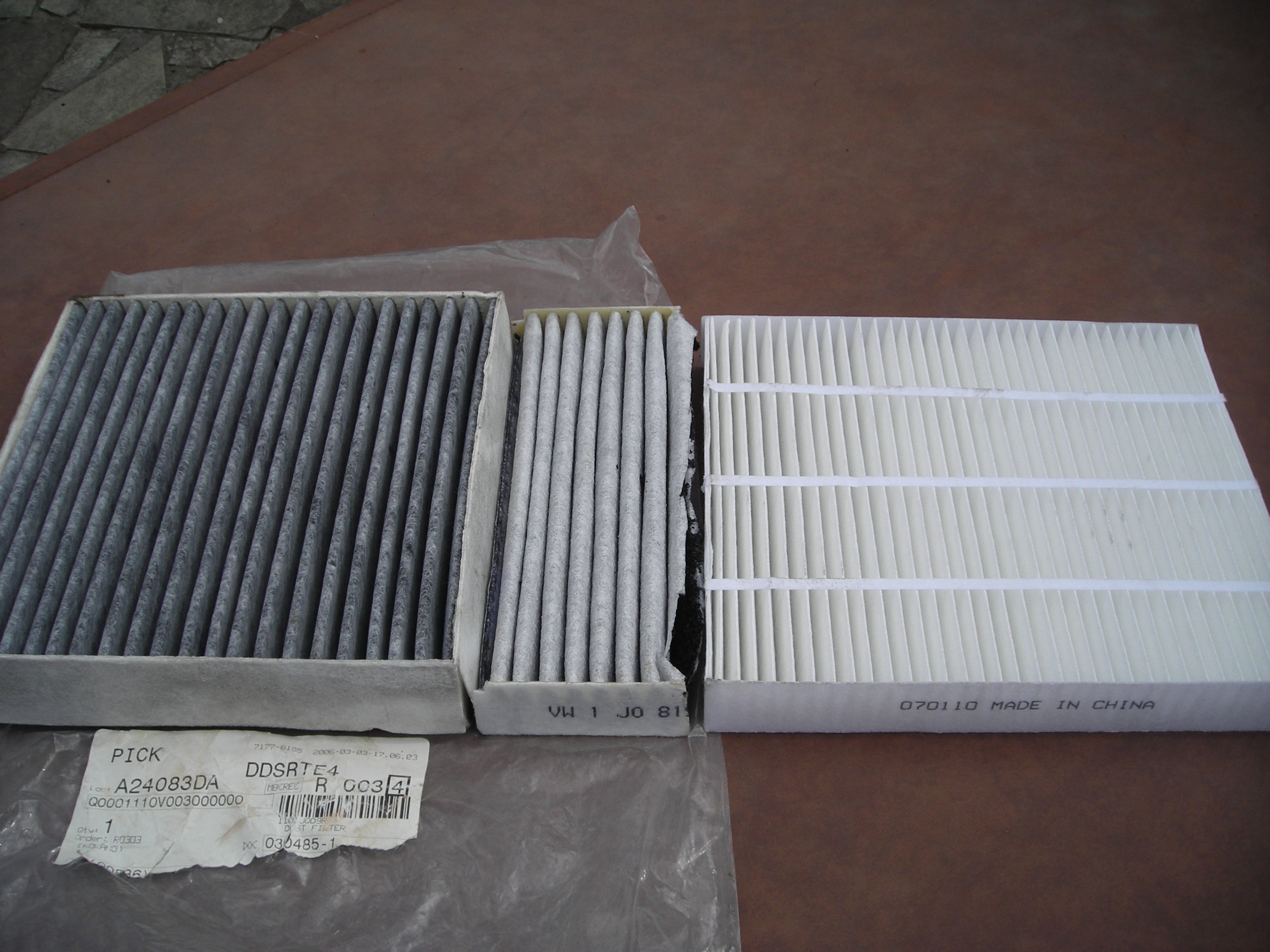

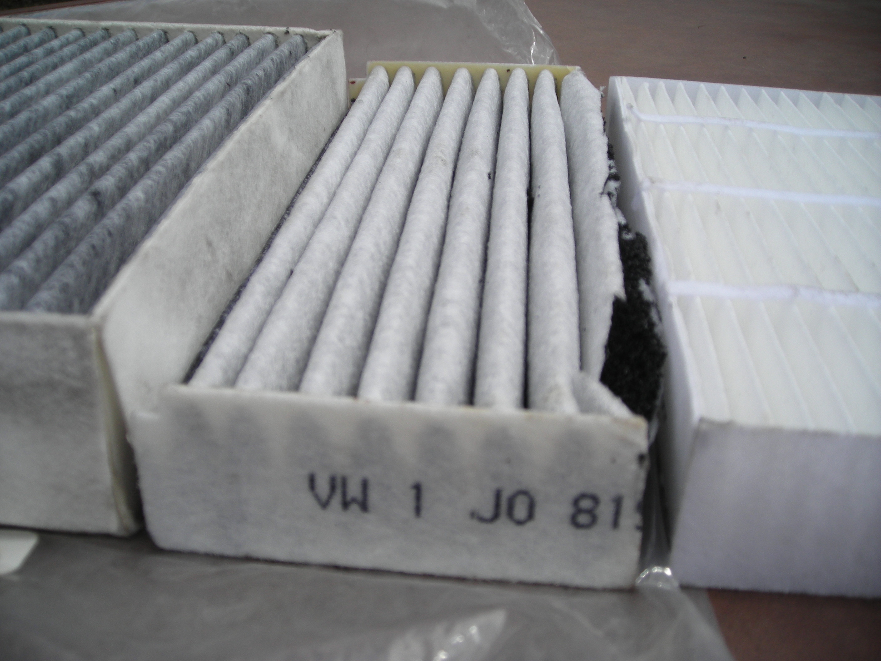

smart142 Posted April 9, 2008 Posted April 9, 2008 Alternate pollen/cabin filterBelow are pictures of the oem filter on the left > $70 ; the napa on the right >$20 (paper)and a VW charcoal cabin filter for $26.27 1JO 819644AA small part (shown in the middle) was cut off.To me it looks like the VW gives the best value for the money. Quote
